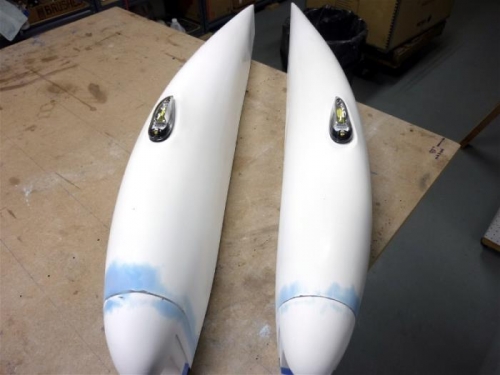

Aligned and rough installed the wing tip (NSP) lights after finish sanding to shape the necessary body putty.

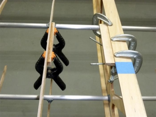

Installed the beginnings of the pitot mounting base. I'm modifying the design to eliminate the two flanges in the factory set up and still allow ease of access should there ever be a need to repair, inspect or replace the pitot tube.

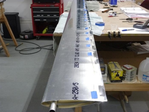

Installed the rivets on the trailing edge of one of the flaperons. Used solid rivets vs. the supplied pull rivets the tail of the pulled rivet is long and ugly.

Wing tips prepped and lights installed
Forming the mount base for pitot
Riveting the flaperon
