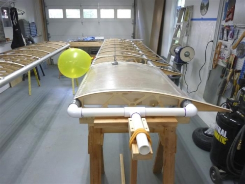

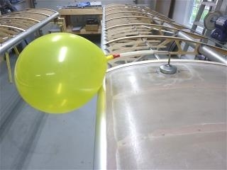

Brief Description:  Completed fuel tank install and leak checked right
Talked to the factory and was assured that there is enough material to remove from the offending corners to take out the appearance of the warpage in the tank and did so.
Also, leak checked the right tank - passed with flying colors.
Leak check
Leak check
