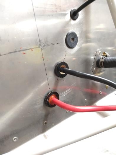

Instrument instal
Installed battery ground wire
Installed more wiring and the ground cable to the battery.
The picture is of the before and after adding the hi-temp rtv to isolate the cable from the firewall.
