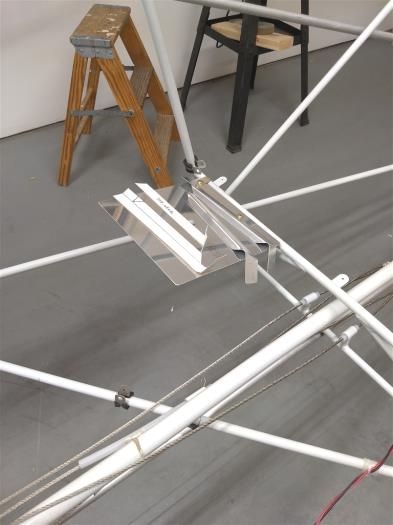

Riveted and bolted the ADSB antenna/ground plane parts together and final installed same.

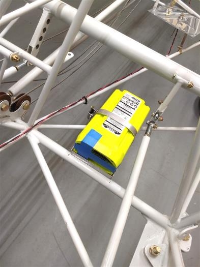

Fitted the wood plug to the welded plate and final installed the ELT,

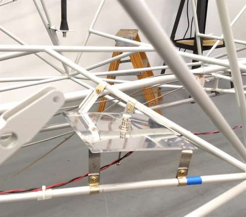

Rough fitted the transponder antenna and fabricated the mounting / support legs. (Awaiting receipt of Adel type clamps to finish the installation.) However, now that I contemplated this installation for a good part of the afternoon, I'm 90% sure I'm going to change my mind and install it one bay rearward. That will put the antennas even closer to the recommended 1 meter separation and, why not, it's too windy to haul rocks and I can't dance!
ADSB antenna installed
ELT installed
ELT installed
First pass, transponder rough fit
