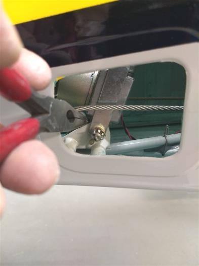

Brief Description:  EAA Tech Counselor Inspection
Jim and Ed made a long drive to inspect the project. Discussed several ways of approaching the next steps (mounting the oil cooler and routing the brake lines) and found a case of insufficient clearance where clearance between the cotter pin on the trim motor and the right rudder cable. Fixed the issue the next day but here was a good place to log the issue and solution.
Cotter pin bent in better position
