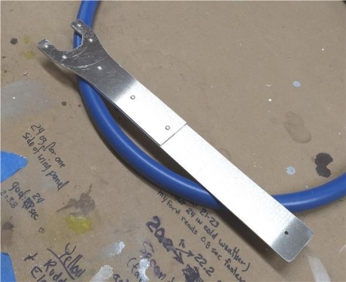

The oil cooler fittings required torqueing to 29 lbft - BUT - it takes a really thin 33mm wrench to do so. Had to make one, then using a luggage scale was able to properly put the fittings on.

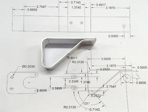

Designed and fabricated a bracket to mount an Adel clamp to route and position the oil pickup line. Did a pretty good job if I do say so my self - until I noticed that I bent it backwards. Crap. The short version of the story is: the third time was the charm.
Torque wrench
Torque wrench
Oil line mounting bracket
