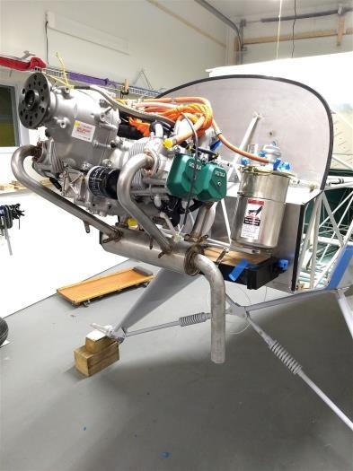

Brief Description:  Installed the exhaust system

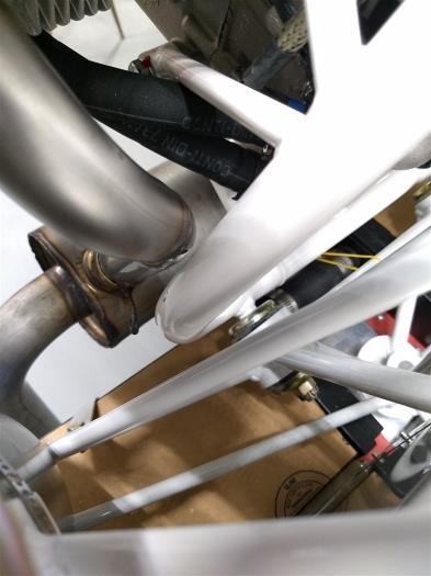

Ran into a minor problem when installing the exhaust system - one of the spring mounting tabs made hard contact with the engine mounting ring. The answer was to cut it off and have the factory send me two new tabs that I will have a local shop weld in place.
Where the tab used to be
Completed the install
