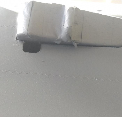

Completed the final prep for another coat of UV paint on the wing panel. Discovered the there is an interference between the bolt/nut used to mount the lift strut to the front spar mount so I opened up a clearance slot. Also, had to wait for help to come over and move the wing panel into the paint both.
If you are reading this - I recommend that you plan for this slot when you add the reinforcement plate around the mounting tab.
Bolt/nut clearance slot
