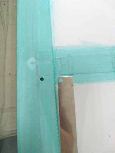

Finished the left wing panel
Completed the required touch up work on the left wing panel and ironed the pinked edges.
Made a metal template and melted in the drain holes.
Uncovered and cleared the flaperon bracket mounting holes.
