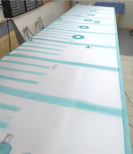

Bottom rib and false rib taping
Finished taping the ribs (bottom of wing panel).
Cut to length and installed the one inch tape over the false ribs (bottom side).
Cut the inspection port dollies, marked locations, pre-glued the areas and installed the plastic rings.
Needs the L/E and T/E tapes
