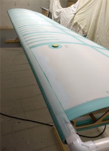

Brief Description:  Glued the second tape in position
Finished gluing the leading edge tape down.
BUT, I thought I had eliminated one of the tapes the Kitfox manual calls out due to the fact the Stewart System has slightly different requirements. Unfortunately I was so focused on meeting the spec and with one four inch tape and not a four and 2 inch tape that I missed seeing that rivet heads under the fabric need their own tape . . . . . so that had to be addressed with either individual dollies or a second tape. The second tape was my answer. Hopefully I avoided the cosmetically inferior approach of an overlap by carefully nesting the pinked edges of the two tapes. Maybe this approach won't show after paint - or - at least be less visible??
Big opps!!
Big opps!!
Close up of second tape
