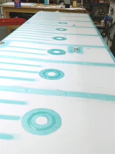

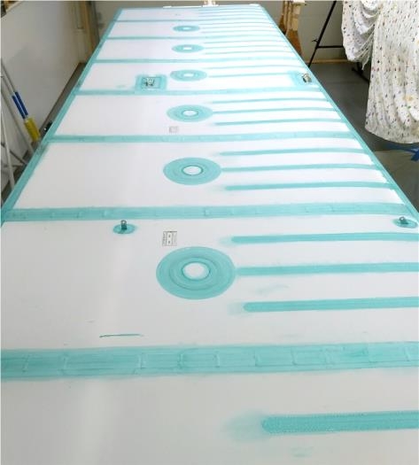

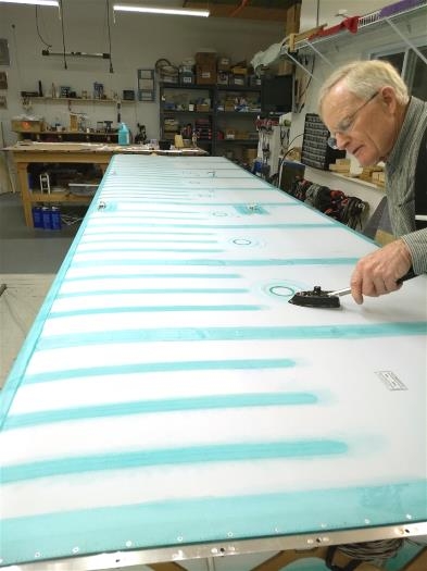

Installed inspection rings and trailing edge tape
Designed and printed templates for the inpection panel rings and location marks for the first bed of glue.
Shrunk one square yard of light weight material.
Cut out 12 inspection panel dollies. (SIx for the left wing.)
Installed the inspection rings and covered with the dollies.
Rough installed the fabric tape around the trailing edge.
