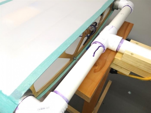

More prep work on the right wing
Wrapped the top and bottom of wing panel fabric around end ribs.
Shrunk top fabric to 245 F
Laid out, cut and installed doilies for the strut attach brackets, the bump at the fuel pick up port and the quick drain port.
Spent some time heating and smoothing out edges and bubbles in the overlaps.
support dollies on both sides of fabric
Wrapping the end rib
