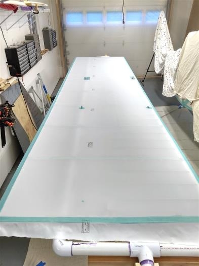

First shrink on bottom right wing
Completed the first shrink (about 240 F) on the bottom side of the right wing.
Printed and installed the reinforcement dollies for the jury strut brackets.
Installed the reinforcement rings around the lift strut brackets.
First shrink completed
