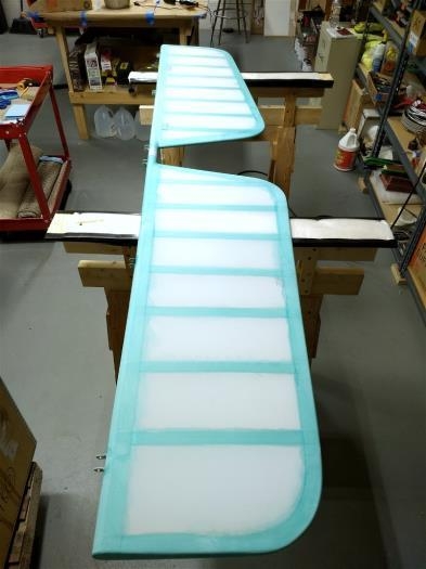

Brief Description:  Completed the elevator
Completed the elevator - including final ironing of all tape edges.
Started covering the rudder.
1. filed all bumps and protrusions.
2. painted filed areas
3. painted Ekobond for chaffing tape
4. added chaffing tape
5. painted Ekobond boundaries
