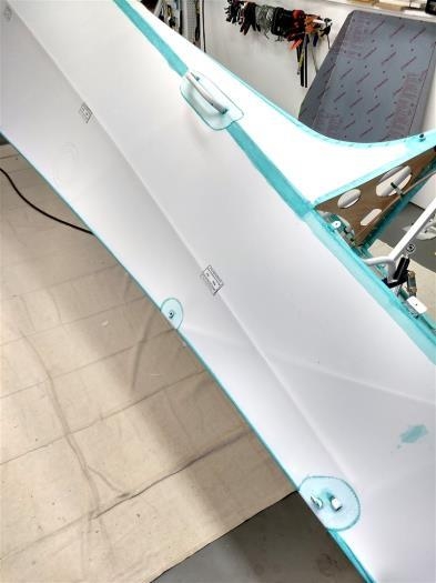

Cut and installed grommets

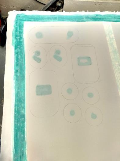

Layed out the grommets on the fully shrunk panel (light weight fabric).
Cut out and installed the grommets shown in image 2 (plus the ones at the lift strut attach point), both sides.
BTW - I made templates for all of the grommets; contact me if you can use a copy of them. I can send them in one CAD file or individual PDF files.

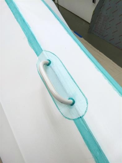

Grommets ready for final glue
Close up - pull handle grommet
