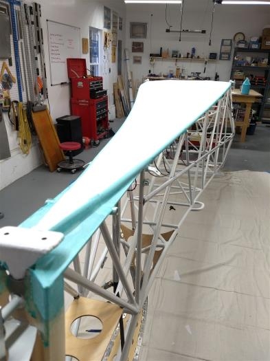

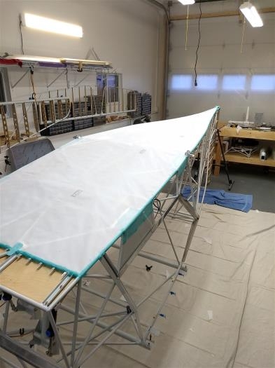

Brief Description:  Fianl glue on bottom fabric

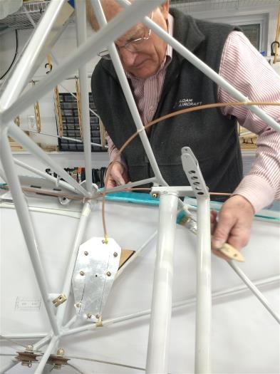

Cut the material overhanging the side rails to size and completed gluing the bottom fabric. Cutting to accommodate the weld joints and the firewall mounting tabs took more time than first expected. Ended up doing the cuts twice in several locations as I learned that more margin is better than an over tight fit.
Gllueing on fabric
Gllueing on fabric
Note detail around firewall clips
glue complete from tail
