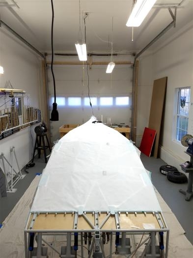

Date:  2-25-2019
Number of Hours:  4.00
Manual Reference:  Covering
Brief Description:  Rough installed fabric on fuselage bottom
Well, I couldn't put the day off any longer and bit the “fabric installation bullet”. The bottom piece is now cut to size and “loosely” glue in. So far I’m really liking the Stewart System – no smells and no toxic chemicals. Tomorrow will be final glue and first shrink.
The first piece of fabric goes on
