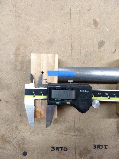

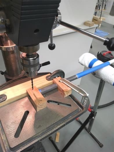

Brief Description:  Drilled missing holes in spring strut
Continued removing powdercoat from the spring tube components - they have components that fit into each other. Two of the major components missed a factory drilling operation so I did spend a bit of time getting the correct dimension from the factory and setting up a drilling operation.
