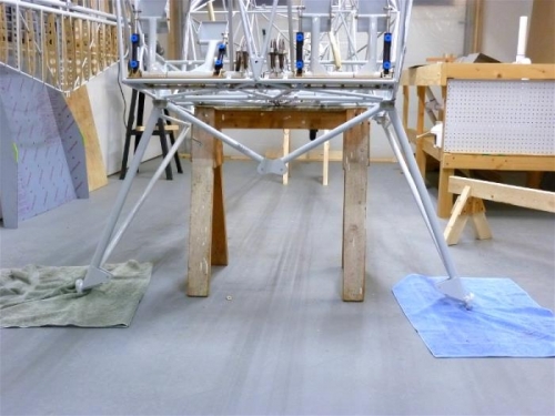

Completed installation of left main gear leg and installed the right gear leg. Not too bad of a job, the components fitted surprisingly well - had to open up the nylon inserts a bit but that was all.

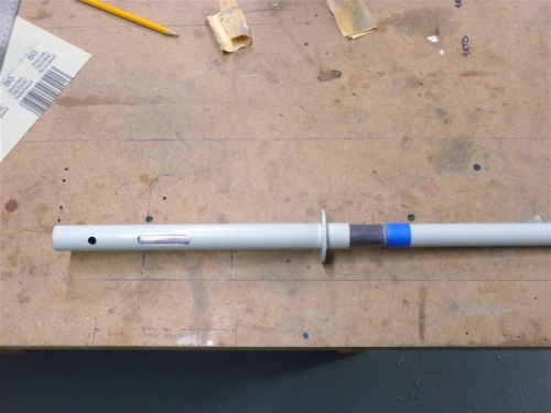

The real issue today was removing the powder coating from the spring bar - good grief that stuff is on thick and doesn't want to come off. Ended up softening it with lacquer thinner and cutting most off with a box cutter, then sanding, then more lacquer thinner to remove the last traces.
Main components are on!!
Fitting the spring bar
