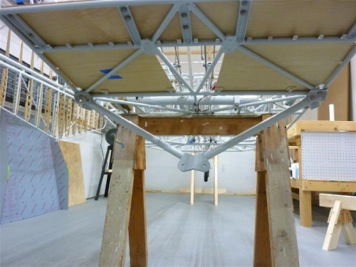

Brief Description:  Began installation of undercarriage components

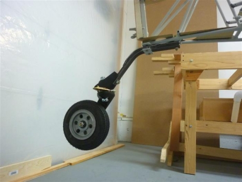

Completed installation of the tail wheel.
Prepped all of the undercarriage components (removed powder coat, reamed holes, etc.) and started installing the components.
First the attach brackets - they fitted really well. The holes aligned to within 0.003 inches. The cabane cross tube structure will require just a bit of filing of one bolt hole and I'll take care of that tomorrow.
Tail wheel
Tail wheel
Cabane cross tube
Cabane cross tube
