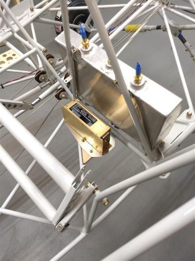

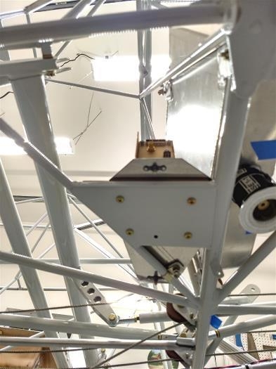

Completed the install of the transponder. Was able to use the mounting block fabricated for the ELT. Unless this too has to be moved, this location will require only a very reasonable cable length, remove an item normally crowding the space behind the instrument panel and still offer reasonable access should it be required.
Also moved the transponder ground plane one bay to the rear (to increase the distance to the ADSB antenna; was able to use one of the stabilizing legs from its first location and ten fabricated the fourth leg.
Transponder behind the header tank
From the bottom
From the bottom
