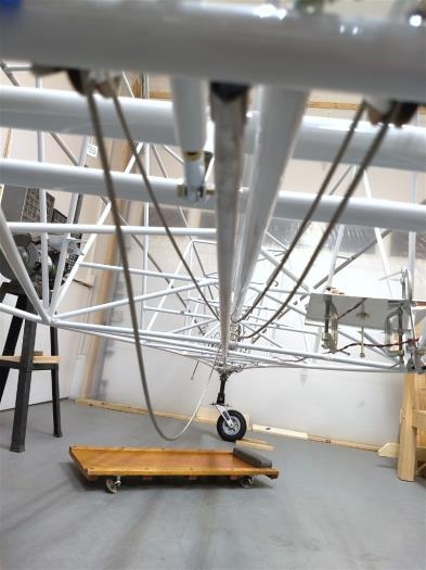

Then the rest of the day was spent determining where to mount the ADSB antenna/ground plane. Not as easy as it looks as I wanted to try and honor the guideline to keep antennas at least 1 meter from each other. Ended up mounting it (or, at least rough fitting all of the pieces) under the floor of the baggage compartment - port side, rear. The biggest (self-induced challenge) was getting it positioned level on the roll axis and at a pitch angle that will be level in flight.

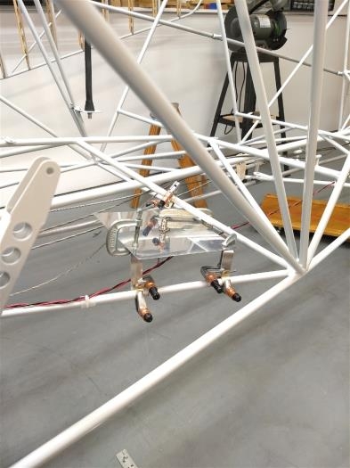

To ensure the antenna won't be sticking its bald ball head through the fabric, I installed the bottom stringer.
Rough fit ADSB antenna
Final install bottom stringer
