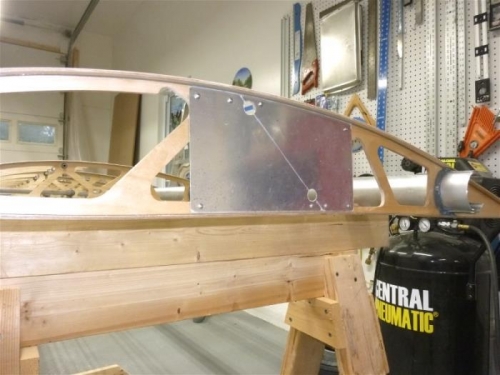

Completed the aluminum plates that mount behind the fuel sight gages.

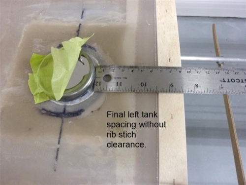

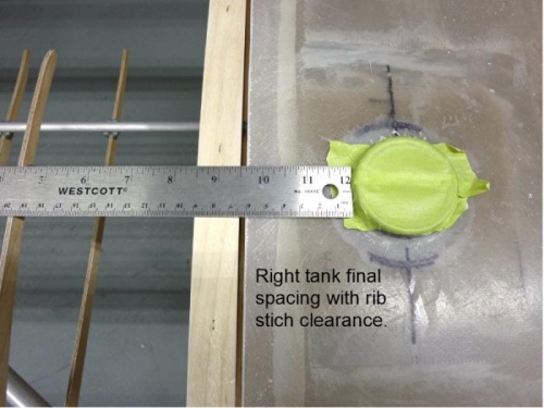

Completed final fit and install details for both wing tanks. I removed quite a bit of flange (mostly on the right tank) so as to be able to remove and re-install the fuel pick up probes (should that ever be necessary in the future) without too much special effort.
Fuel gage plate
Fuel gage plate
Right tank flange
Right tank flange
Left tank flange before positioning
