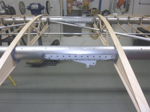

Brief Description:  Finished install of wing strut attach brackets
The learning curve was in full force today - installed three (the last three) wing strut attach brackets. OBTW - heating the "white" part of the Hysol to about 105 - 110 did cause the crystals to go back into suspension and all was creamy again.
