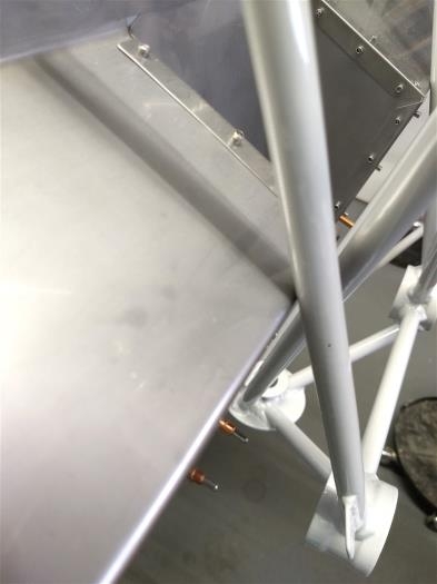

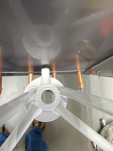

Fabricated the special washers used when mounting the truss behind the engine mount and installed it to verify the fit and placement of the engine coolant radiators, Discovered that two down tubes made hard contact with the foot wells and wouldn't allow the bottom mounting feature to engage the firewall. Contacted the factory to verify planned response.

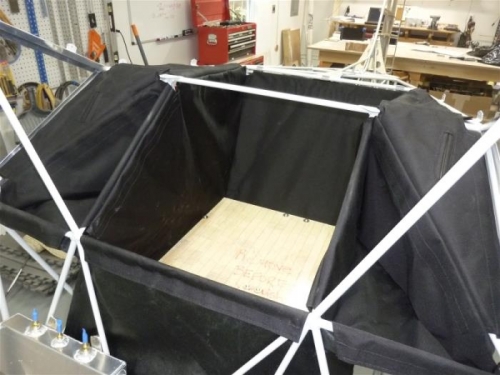

Installed the baggage area sack - then removed it and epoxied the drilled holes and edges.
Hard contact
Hard contact
Won't engage
Won't engage
Cargo sack installed
