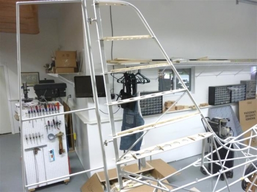

Brief Description:  Installed ribs in VS

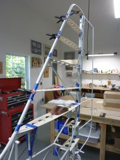

The 2.5 hours here represent finishing the fitting of the stabilizer ribs, clamping them in place and then putting on just enough epoxy to hold them in place without the clamps - in preparation for making the application of the finishing epoxy easier (clamps out of the way).
