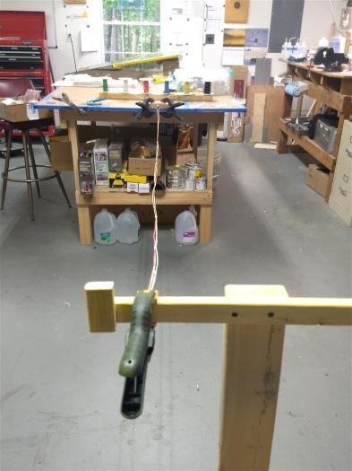

Began fitting the landing light lense on the right wing tip.

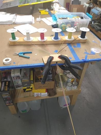

Banded the wing tip wires into a common cable and pulled into the rear spar.
