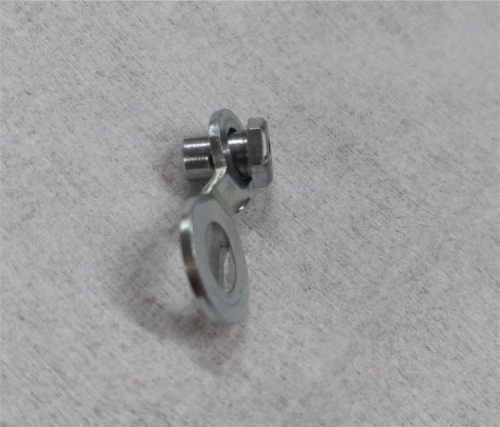

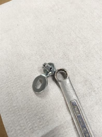

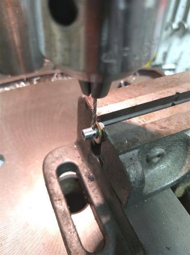

Discovered that the choke cable wire end clamp just wasn't up to par so I set about finding a fix. After detemining that it was a KF sourced part (and, therefore not an unbeilievably priced Rotax part) thought I'd attempt to reposition the cable thru hole and reduce the thickness of the hex feature on the part.
All went well in modifying the parts but the cable ends didn't do well with the multiple insertions and finally fraid to the point that one end wouldn't allow another insertion. So, another cable will be ordered.
New thru hole
New thru hole
Note reduced head thickness
Completed wire end clamp
