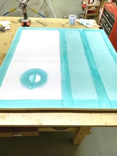

Brief Description:  Test panel first coat of fabric sealer
Covered the inspection ring.
Painted one coat of fabric sealer. A big opps here by the way. Was to mix the ekobond 3:1 (ekobond to distilled water) and made a huge mistake when weighing out the water. It is a long story but suffice it to say it was really thinned; I'll bet I won't make the same mistake again!!
First really thin coat (right side)
