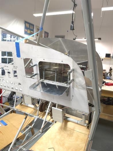

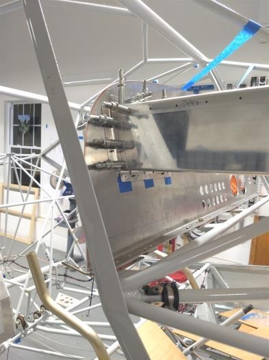

Brief Description:  Map Box modification and install
Today was most interesting if not challenging. It turns out that I had failed to consider the features of the fuse box and map box that are behind the panel - a time consuming oversight. I soon discovered that installing the box required moving it to a different location - and making several changes the move necessitated. Not wanting to pass up an opportunity to make it a really long day, I decided to "tilt" the box down 10 degrees. I had flown in a tail dragger in which this hadn't been done and opening the map box any time after landing caused, or at least allowed, all of its contents to fall out. Ten degrees doesn't quite match the slope to make it level but I'm hoping that the 2 degrees it leaves is not enough to cause the problem. So, the deed is now done and tomorrow will be dedicated to riveting it together
