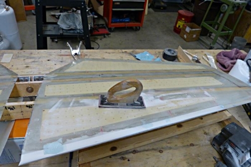

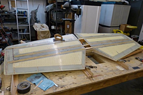

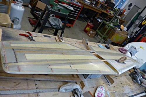

Sanded filler on leading edge
Sanded filler on leading edge and covered with fiberglass tape as described in the instruction book. Made a cover for the bolts that fasten the control horn to the elevator spar. Bonded the covre on with epoxy/microballons.
