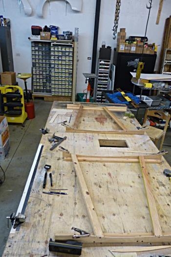

Brief Description:  Stabilizer skin supports
Added wood 1x2 supports between stabilizer end pieces to keep skins from sagging between the tip and root ends. This will help keep skins straight from tip to root as ribs are fit and bonded.
Note the two small vises on the left side of the table. These came in handy to hold the spars while fitting the hinges and control horn or sanding the spar edges to conform to the skins as suggested in the instructions.
The little spring clamps near the corners of the stabilizer supports are to fix the location of the skins so they can be put back where they were after you remove the them for some reason.
Added supports to stabilizer cradle
