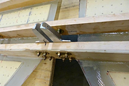

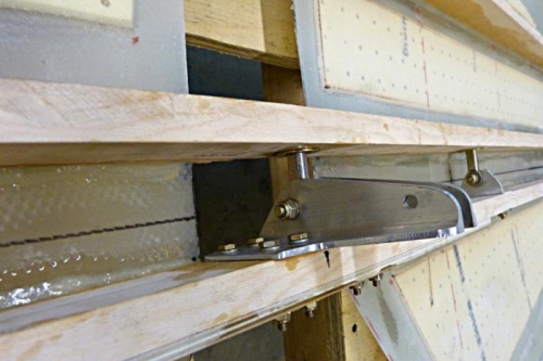

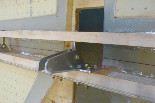

Brief Description:  Continued work on rear and elevator spar.
Worked on rear spar and elevator spar to get hinges mounted and aligned so elevator spar would move smoothly. Sanded top and bottom of the spars so they would fit square on the skins. Bonded the spars to the skins. Used wieghts on the spars to insure a tight glue line to the skins. Put folded towels under the skins to put pressure on the skin to spar joint. Made sure skins and spars were in alignment as the epoxy cures.
