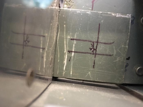

Initial measurements showed the sweep within 1/8" all the way across, square to fuselage within 1/16” measuring from a rivet near the tip of the main spar to a point just forward of the F-711 bulkhead, and incidence within 0.1 to 0.2 degrees. I had pre-marked both the rear spar fork and rear spar stubs for edge distance, and ended up with a 1/4” tall by 1/8” wide rectangle where the bolt holes could be centered and still meet the 2X edge distance requirement on all parts. I lightly center punched a hole location in the center of that rectangle on both sides and walked away (per the build manual…).

Plenty of real estate to meet edge distance requirement
