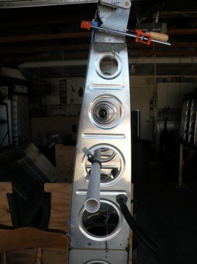

Next was fitting the left flap. Because the flap and aileron hinge lines are in different chordwise locations, I set the aileron in its neutral position so its trailing edge would properly serve as a reference for the trailing edge of the flap. Insead of the wood fixture shown in the plans, I used a taught thread between the aileron trailing edge radius and the forward tooling hole. I taped and clamped a long 3/16" bolt to the trailing edge, and tied one end of a length of nylon thread to it. I tied the other end to a 3/16" cleco. The length of the thread was several inches shorter than the distance from the trailing edge to the forward main rib tooling hole, so it could be stretched, thus making it "straight as a string"(Photos 1 & 2). I used a clamp to adjust the aileron position until the string centered in the main rib aft tooling hole.

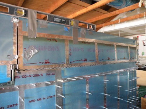

After clecoing the bottom skins on, I aligned the flap to the aileron by taping half of my 4' carpenter's level to the flap such that the trailing edge of the flap nested in the groove on one edge of the level. I clamped the flap hinge in place such that the aileron trailing edge nested in the groove in the outboard half of the level. I used 1/4" bolts to set the spanwise gap between the two control surfaces. (Photo 3)

My nylon thread alignment tool.
Closeup showing the thread splitting the main rib aft tooling hole.
Flap clamped in place ready to drill the hinge.
