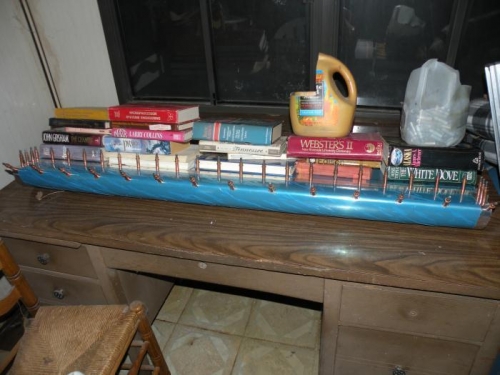

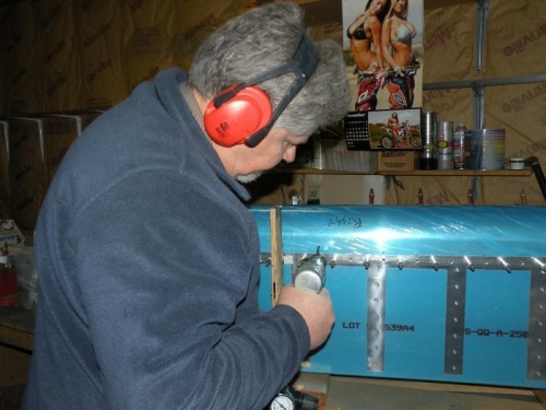

I then clecoed and riveted the main skin to the spar, leaving out the end ribs and topside clecos for access to the interior of the aileron with my small tungsten bucking bar (Photo 1). I then riveted the top of the nose skin to the nose ribs, followed by riveting the main ribs to the spar and the top side of the main skin. I then used a #30 male dimple die in a rivet gun set drilled to accept it to dimple the nose skin into the countersinks in the counterbalance pipe.

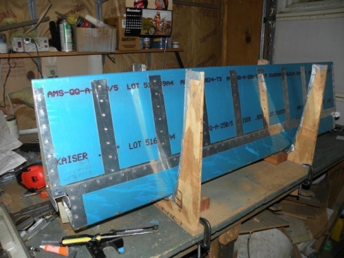

The aileron is still a bit flimsy at this point, so to help ensure a twist-free asssembly, the instructions have you weight it down on a flat surface before riveting the skins to the counterbalance pipe and the bottom of the main spar (photo 2). After installing all of the pop rivets, I finished up by riveting the bottom of the skins to the main and nose ribs, and installed the hinge brackets, torqueing and sealing all the fasteners.
This aileron is DONE!!
