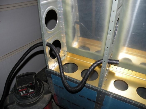

I also got started on pulling conduit in the left wing. I got the conduit through the first four outboard ribs. Ten to go...
Beginning pulling of conduit in left wing. Tedious but doable...
