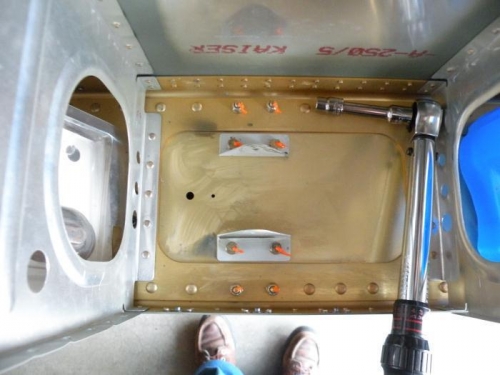

Date:  1-5-2013
Number of Hours:  1.25
Manual Reference:  p 7-2
Brief Description:  Tiedowns and Aileron Bellcrank Brackets-Both Wings
Not much today; just installation of the aileron bellcrank brackets. The bolt holes in the brackets had enough powdercoat in them that I needed to run a 3/16 drill through them and clean them up. I primed the exposed steel in the holes, and installed the bolts with wet primer. After torquing the tiedown attach nuts and bellcrank bracket bolts, I torqued them and applied torque seal.
Right tiedown and aileron bracket bolts torqued and sealed.
