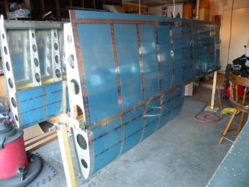

Finishing up the outboard end of the main spar.
Wing rotated 180 degrees in the stand for easier access to rear spar rivets.
DONE!
