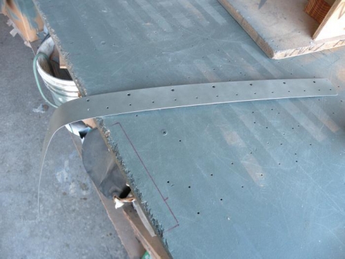

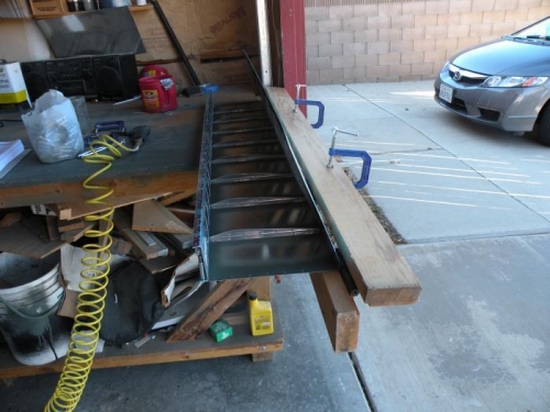

I spent the rest of the day on the ailerons. I used the same borrowed bending brake I used on the elevators. To gauge the bend I installed the spar backwards (photo 2). As with the elevators, I clecoed the skin to the bench to prevent it slipping. The aileron skins were quite a bit harder to bend than what I remember the elevator skins being. They are both 0.020, so I'm guessing it's the extra length.

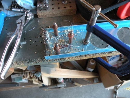

After completing the bends, I fabricated the aileron reinforcement plates, per the instruction manual (before discovering the pre-cut ones...). I then match drilled the plates to the spars, and drilled the bolt holes in the steel brackets to 3/16 and reamed them to #12. I finished up the day by final reaming the nose ribs to the spar.

Set up to complete the bend on an aileron skin.
Match drilling an aileron spar reinforcement plate.
