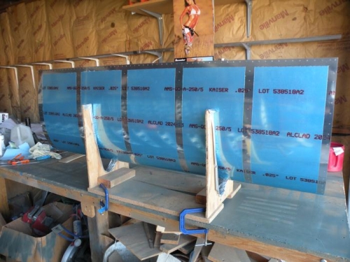

Nearly two weeks since working on the RV-7, and I was nearing withdrawl...
I thought I was going to be able to rivet the right leading edge together today, but when I pulled out the parts, I noticed I hadn't dimpled the skin or ribs. The same was true of the four main skins, so I de-vinlyled, deburred (holes and edges) all five skins, and rolled the edges of all except for the top outboard skin. I still need to scarf the forward overlapping corners of the main skins, then I'll be ready to dimple all five skins.
