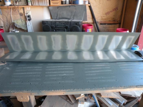

Brief Description: Ailerons, Right Wing
Ailerons (2.4 hrs)
I started by scuffing and cleaning the aileron stiffeners and skins. As with the lower wing skins, I used scotchbrite and Dawn detergent to do the job. After drying, I primed all the scuffed surfaces.

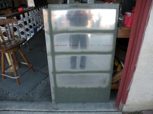

Right Wing (5.3 hrs)
I removed the top main skins from the skeleton and de-vinyled them. I then deburred, scuffed, cleaned, and primed the top main skins and wing walk doubler. After putting all the primed parts in the house for curing, I deburred all skin rivet holes in the wing skeleton.
Left aileron skin scuffed, cleaned, and primed.
Right top inboard skin deburred, scuffed, cleaned, and primed.
