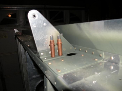

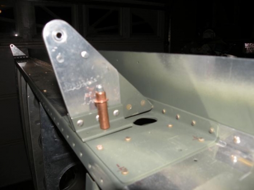

While Karen was taking care of the the ghosts, goblins, and princesses, I worked toward completing the aileron brackets. I first fit the left brackets to the spar. Both required a bit of trimming on the top edge to clear the top flange of their spar reinforment plates. I then match and final drilled them to the spar, and re-primed the trimmed areas.

Left inboard aileron bracket needs a bit of trimming to fit the rear spar.
Trimmed, final drilled, re-primed, and ready to rivet.
