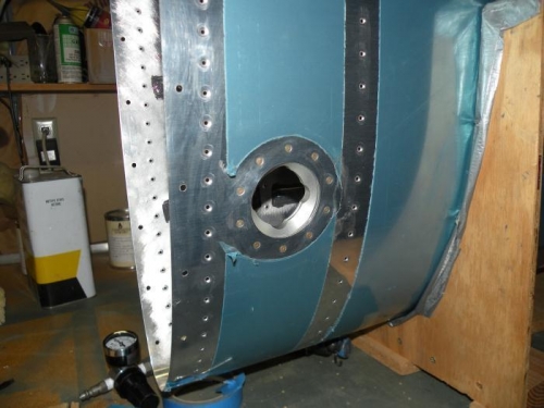

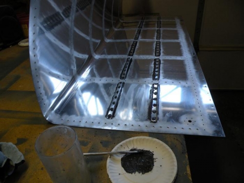

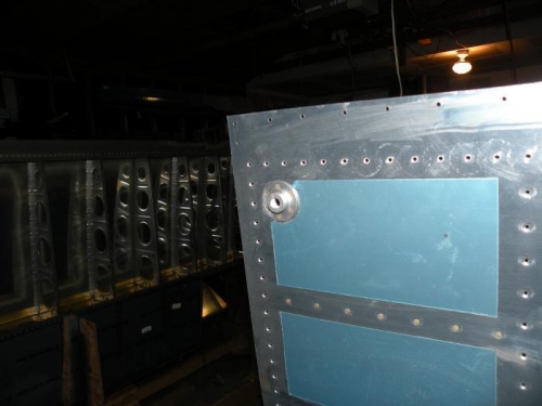

Today I got started on sealing the right tank. I riveted, filleted, and encapsulated rivets on the stiffeners. I then riveted and cleaned the drain fitting and filler flange, including the vent line clip. I found toward the end of sealing the left tank that the rivets are more flush if they are cleaned of sealant on the outside before riveting. I did all rivets today that way with excellent results.
Rivets Today: 94 Rivets Total: 4646
Stiffeners riveted, filleted, and rivets encapsulated.
