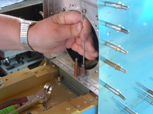

Today I finished final reaming leading edge. I then match drilled the inboard z-brackets through baffle and rib flange holes (photo 1), removed the leading edge, and match drilled the outboard z-bracket. After removing the tank skin and interior ribs, I match drilled the interior z-brackets through the baffle holes.

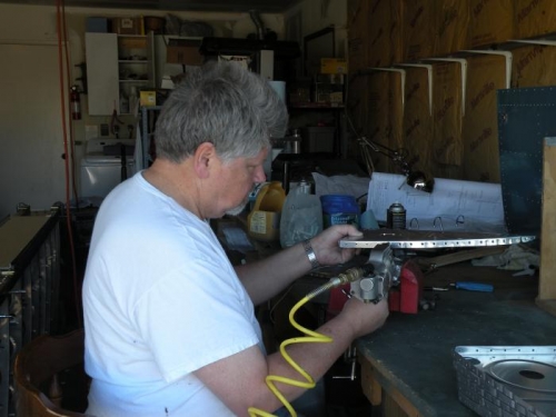

I then partially reassembled the tank and match reamed tank rib aft flanges through the baffle (photo 2).

Match drilling inboard z-bracket.
Setup for match reaming aft flange of tank ribs through the baffle.
