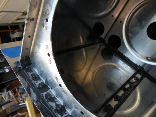

I had planned on going down to Paul Rosales' movie night, but by the time I got to this point, it was too late, so I just decided to go ahead and finish the tank. I mixed up a small batch of sealant and encapsulated all skin to baffle rivet shop heads, and laid a thin layer of sealant along the baffle to skin seam before removing the making tape. I then encapsulated the end rib rivets and filleted the thick beads of sealant in the corners of the tank.

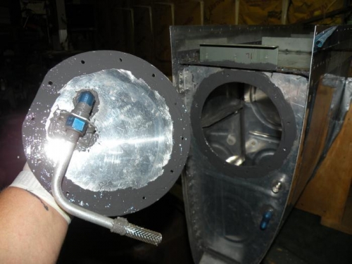

I then scuffed and cleaned the faying surfaces of the tank access cover and interior end rib where the cover attaches. I spread a liberal layer of sealant on both parts, and attached the cover using torx-head screws from McMaster-Carr instead of the supplied phillips screws.

Well-formed bead fillets inside tank.
Access cover ready for installation.
Cover attached with torx-head screws, and tank mounted on spar.
