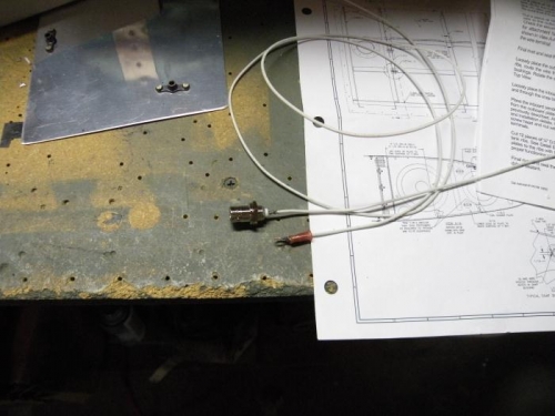

Brief Description:  Left Fuel Tank
Not much time tonight, so I just fabricated the two wires internal to the tank for Van's capacitive fuel sender kit. I soldered the15-inch one to to the supplied bulkhead BNC connector. The other end will eventually get a terminal which will attach to the inboard plate. I crimped and soldered the 48-inch one to a supplied crimp terminal. This terminal will attach to the outboard plate, and will eventually get another terminal which will connect to the inboard plate.
