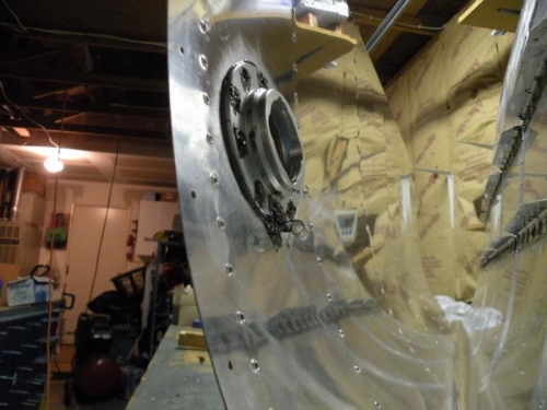

Tonight I finished riveting the fuel cap retaining ring in place. I used -4.5, -5, -5.5, and -6 rivet lengths to accomodate the varying thickness of the machined flange. There are no -5.5 rivets in the kit, so I just cut down some -6's. I got sort of lucky in that I forgot the vent line clip until I only had one more rivet to go; luckily it was the correct one. I'l rather be lucky than good any day...

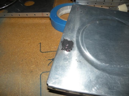

I had a small amout of sealant left from the fuel cap ring, so I cut down an AN470-6-7 rivet to a -5 length and filled the aft tooling hole in the T-403 outboard end rib. After scuffing, cleaning, and applying sealant around both sides of the hole, I used my 3X rivet gun at 90 psi with my tungsten bucking bar, and it set just fine. I finished it off by encapsulating both the factory and shop heads with sealant. The forward tooling hole in both end ribs get covered by the T-405 attach angle and/or T-410 reinforcing plate, and the aft tooling hole in the inboard end rib is covered by the access cover stiffening ring.

Fuel cap retaining ring riveted and cleaned up.
Interior view of retaining ring with vent line clip.
A 3/16 rivet fills the tooling hole at the aft end of the outboard end rib.
