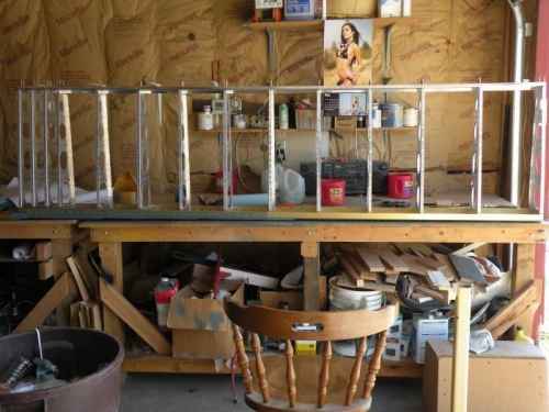

Next up was fluting, which I was able to get done on all 28 in just over an hour using the edge of my workbench as a reference (Photo 1). I was able to get most ribs to the point of not being able to see between the bench and rib web by fluting roughly every other space between rib holes. What seemed to work best for me was to start in the middle, work toward one end, then come back and work toward the other end. Note that not all flutes are created equal...

I fluted the main ribs using the workbench edge as a reference.

Assembled left wing skeleton. Beginning to look like a wing!
